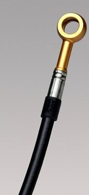

Im also going to buy new SS brake lines for the front. Gonna pull em off & get the specs this week for the order.
