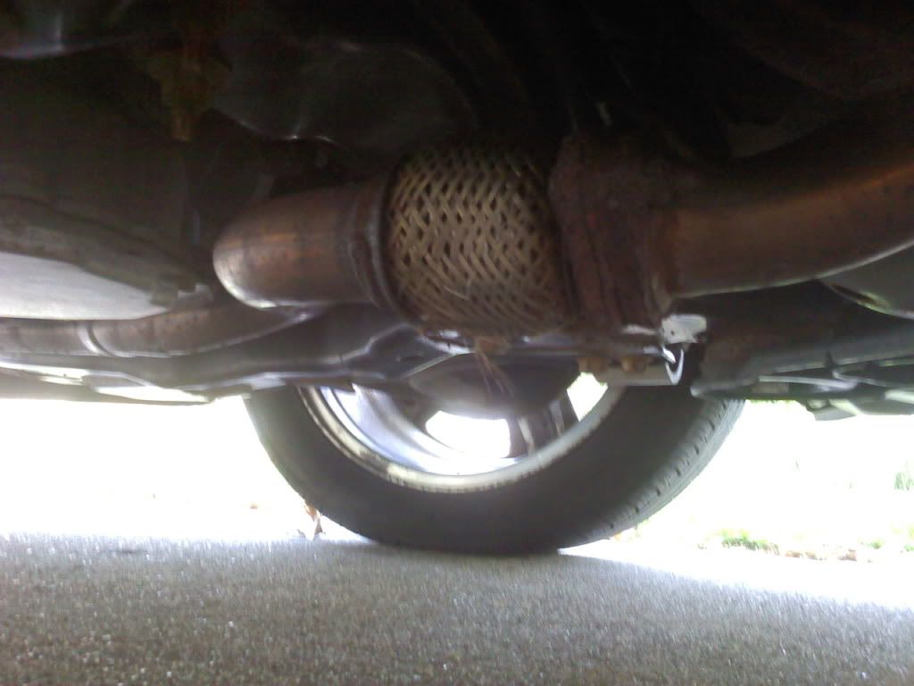

heat shield isn't loose, but while i was under the car i noticed this...
im not sure what the mesh looking thing is called so please inform me; if you look at the bottom of the "mesh" piece its frayed at the bottom would this be my noise?

That is your flex pipe...dang....did you park in some salt water??

post #7 of 14 (permalink) Old 09-28-2011, 01:33 PM
Yeah your fine....its just a connector from your downpipe to the exhaust. It allows it to flex and move some. Yeah I was serious....looks like rust city.
Then again I live in the south....maybe thats normal up there.
any idea what that'll cost to replace... im going to say that it is normal sense its not garage kept and with the weather we get around here. thanks for your help poon

Then again...I would just search for and buy one and pay labor to cut and weld it in.

Noooooo....you can pick up the part and have someone weld it in.
You dont need the whole thing. A 2.25" flex should be less than $50.

i understand what your saying.. i seen the megan racing for 50 bucks. but that link you sent for the other thread said gmpartsdirect wanted 300+ for it? lol
Edit: re-read. that was including the cat! never mind!
so this megan racing will work if i pick it up, obviously the shop will have to wield it i know that much, but it wouldnt give them any trouble?
