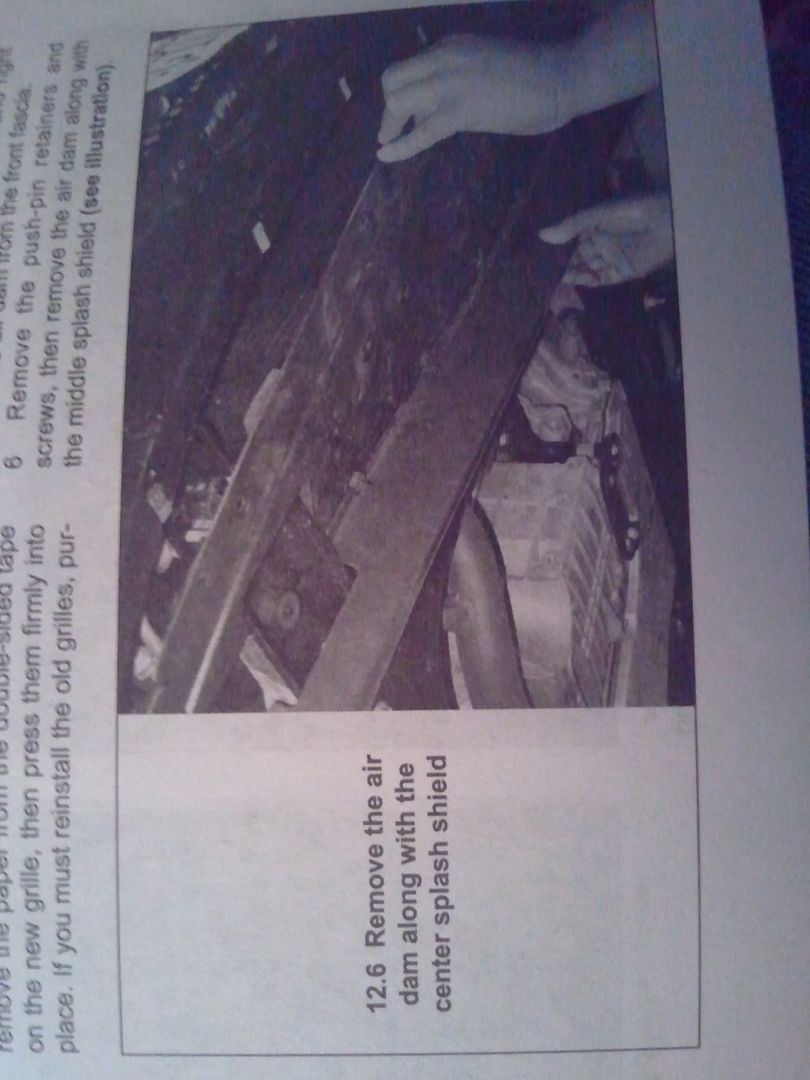

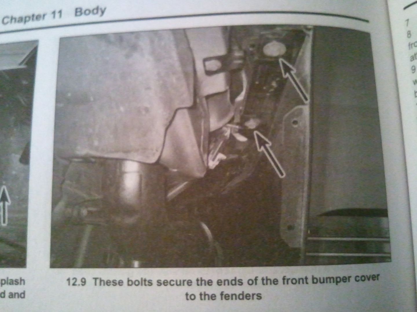

Ok...this is from the Haynes Repair Manual, Pages 11-7 #12:
See post#2 -
post #7 of 10 (permalink) Old 11-17-2011, 03:34 PM

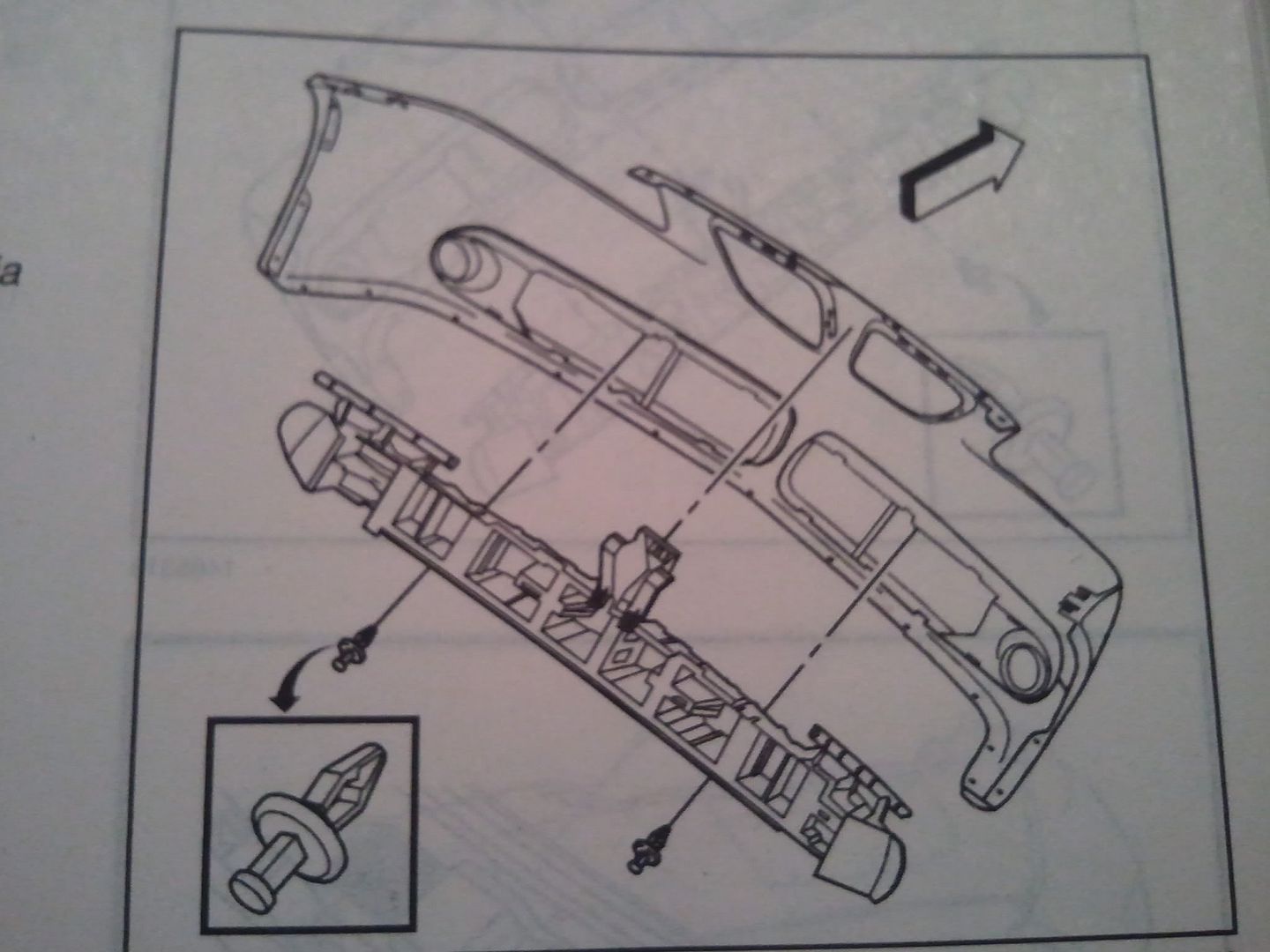

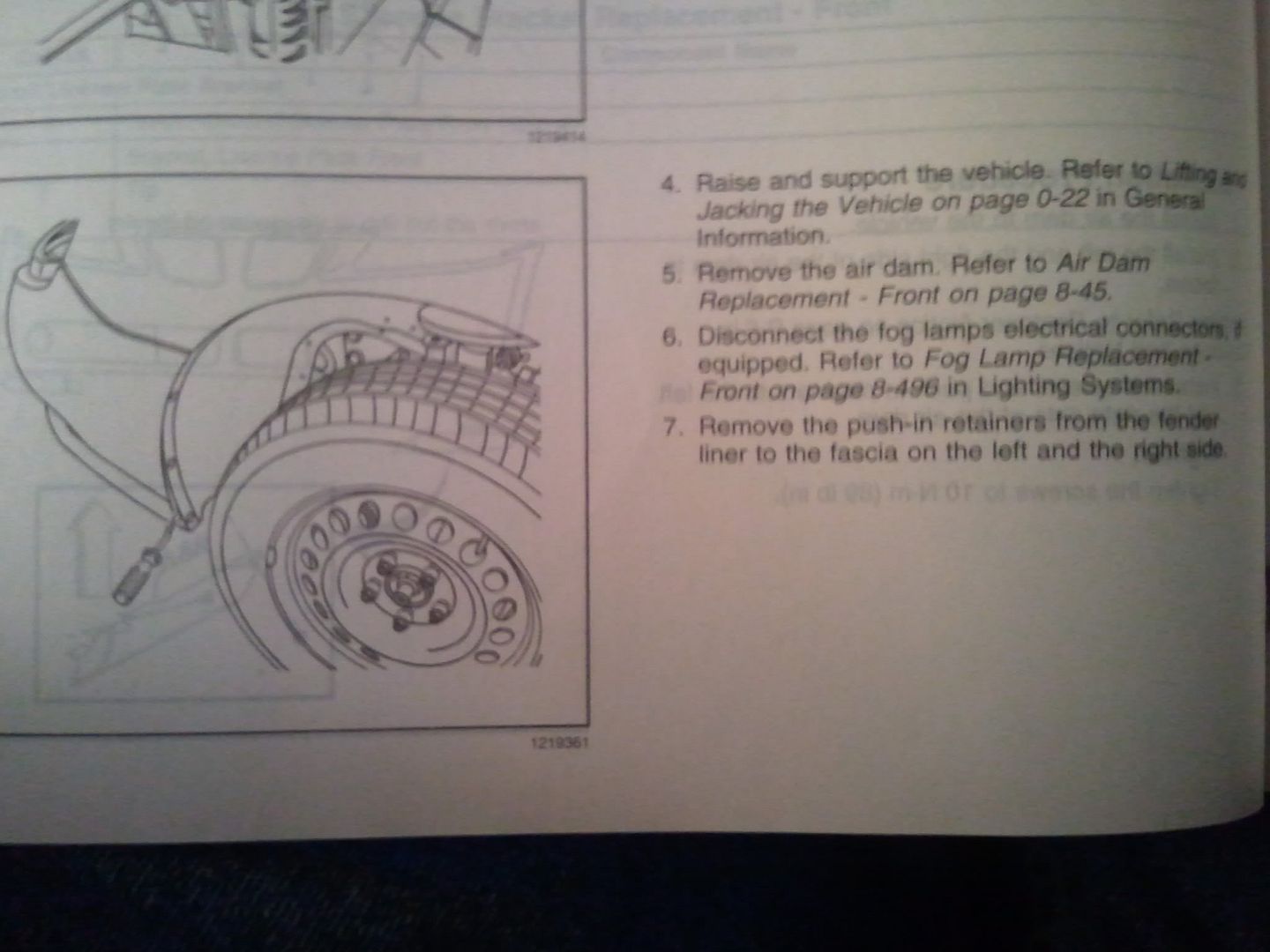

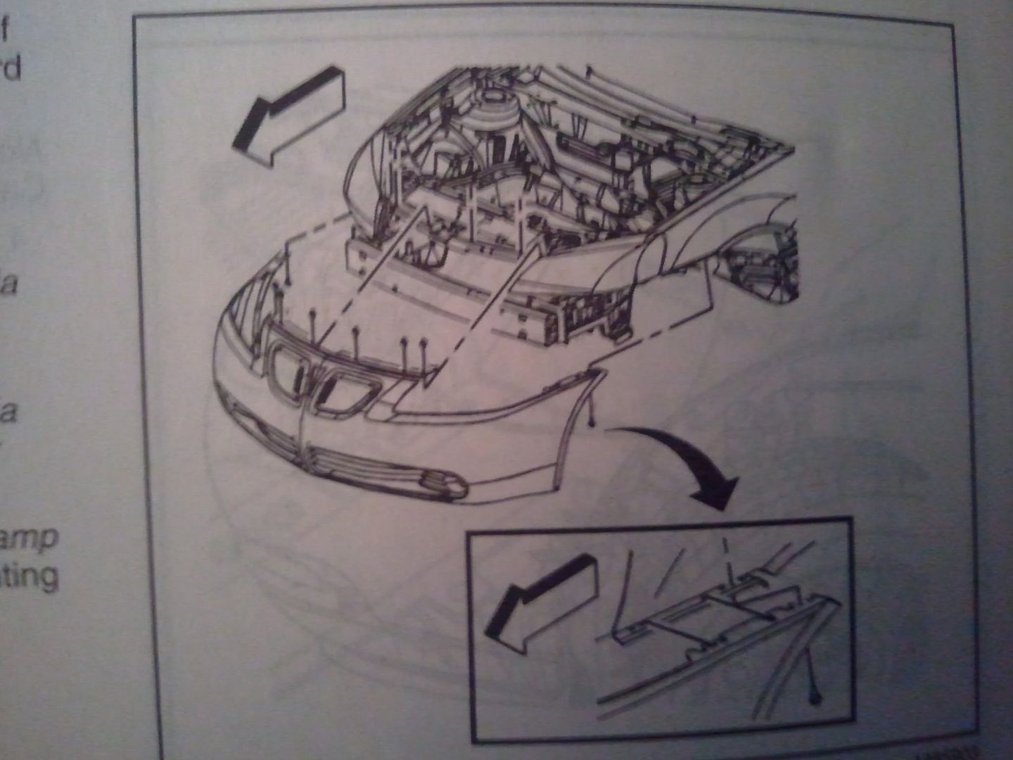

These are from the Service Manual volume 2, Pages 8-46 to 8-49:

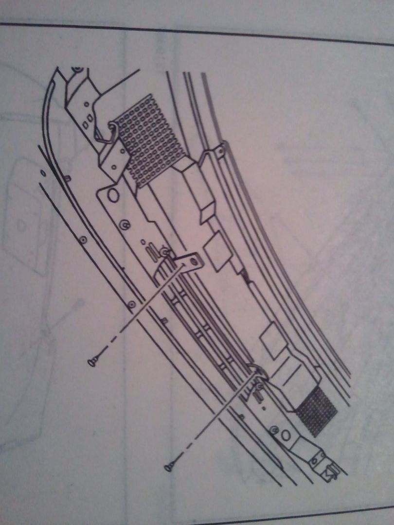

post #8 of 10 (permalink) Old 11-17-2011, 04:18 PM Thread Starter
Lampoon, you are the best.
Hate to ask for one more thing. In the Service Manual, can you get me the Bumper Absorber Replacement pictures? Page 8-53.
post #9 of 10 (permalink) Old 11-17-2011, 05:53 PM
Sure...:
post #10 of 10 (permalink) Old 11-17-2011, 07:49 PM Thread Starter
Awesome. Those helped a lot.
