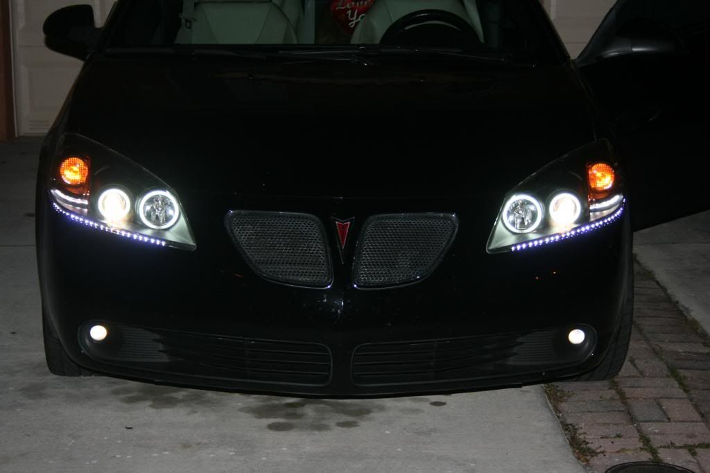

Will the heat from the oven (I've read to use a temp varying from 100 to 175 degrees from 20 to 45 min) bother or mess up the CCLF internal components? Taking off most of the wires & bulbs is easy, but some of the wiring is embedded and wont come out. I 'think' that these are called eagle eyes, but I'm not sure. Maybe the photo will help.
