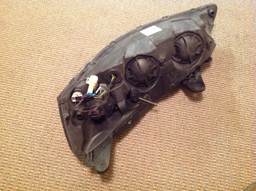

Second step

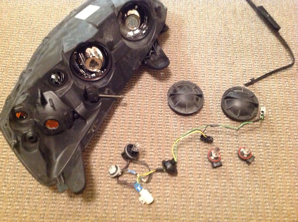

take headlight and take off all extras. This includes the sealer strip and lights
Be sure to take off all wires and bulbs

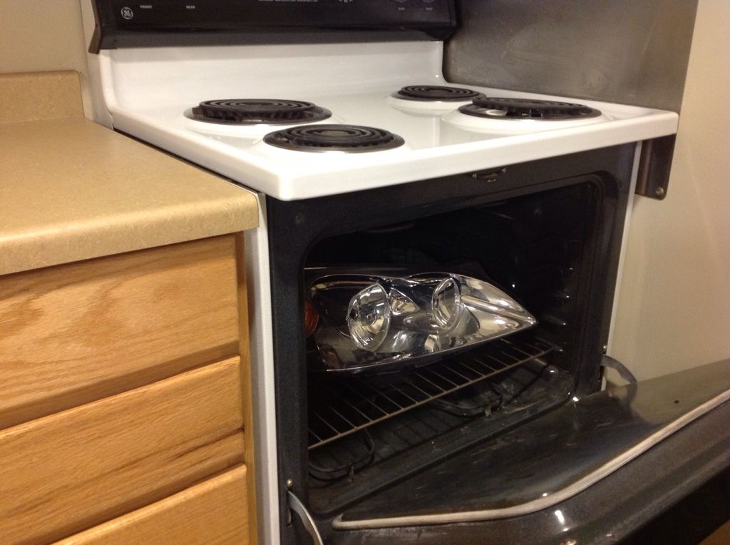

Pre-Heat oven to 200 degrees F
Place headlight in oven at 200 degrees for 20 min
Do not go over 200. If you forget about the light and leave it in for 25-30 you should be okay.

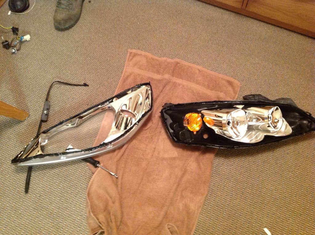

Step Four
Using both screw drivers lift up on tabs and carefully pry lens off housing one by one to make sure you dont brake anything

Step Five
Remove T-15 screws from chrome housing and lens, than use flat head to remove tabs at top of chrome shroud and carefully pry apart
Also once apart use flat head to remove reflector
