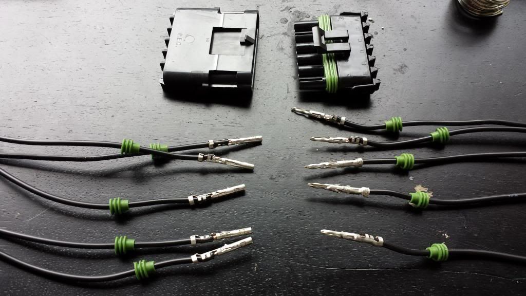

On to the new connector assembly
These are the parts laid out – Grommets, Pins, Connectors, and Bodies.
Image-02
You’ll notice that this connector is made for 6 wires (the pins are labeled “A” – “F”), you only need 5 (so leave “F” empty, you’ll fill that with the silicone sealant later).

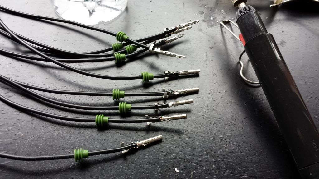

Plug in your soldering iron to heat it up. While you iron is heating, cut your wire into 10” lengths (this gives a bit extra in case of mistakes). Strip approx. ĺ” of insulation off of both ends of the wires.
If you’re not used to soldering, you may want to practice on a few pieces of extra wire.
Apply a little bit of flux to the ends of the wire (easier to do this part one at a time). Heat the end of the wire with your iron, the flux burns off any oxidation from the wires.
Touch your solder to both the wire and iron tip at the same time until you get solder melt. The wire will wick up the melted solder. Remove the solder, then the iron and let cool. Do this to all your wires.

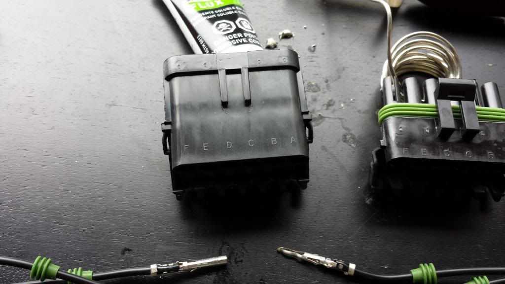

Next, you will want to separate the parts to your connectors. There will be the male and female body, pin and socket connectors, and the grommets. The body of the connector will be labeled on one side “A” thru “F”.
Image-04
The part where the letters are is where the assembled wires will be inserted. One side will actually be inverted when you plug the 2 connectors together at the end so that the letters will match up.

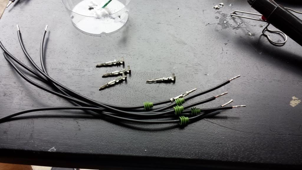

After you have tinned all the wires, slide a grommet onto the wire to a point about the middle of the wire.
Then get the pins and connectors together. Apply a small amount of flux to the inside of each connector’s barrel and slide a wire into the barrel.
Image-05
When inserting your tinned wire into the connector keep the insulation a short distance from the barrel to keep it from melting from the heat. Add a small amount of solder to your iron and touch the connector to the iron. You should see some solder get sucked into the barrel.
Please: do not to put a big blob of solder on your iron as too much will obstruct the locking pins of the connector. It’s a pain to clean those out. If you do get some on the locking pins, use the solder extractor to remove it by heating up the solder and extract (suck off) the extra solder.

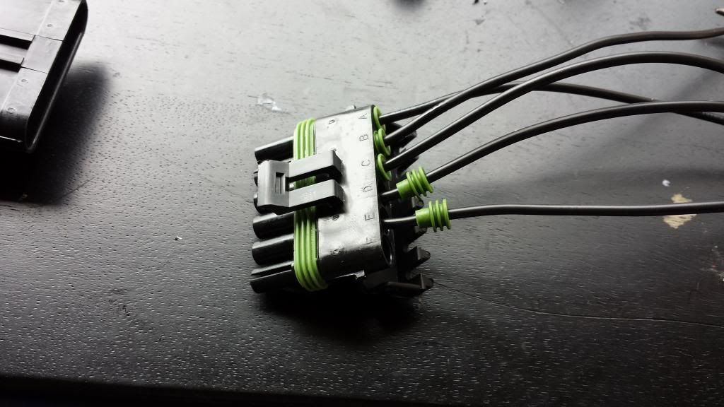

Starting from “A” insert each wire in firmly until you hear a light ‘click’ of the locks snapping into place. Then slide the grommet down the wire and into the hole as far as it will go. It should end up flush with the back of the connector body.
Image-09
You may need to use a small flathead to push it in completely.
