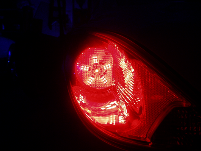

I bought a pair of 3157 LED tail lamps a couple months ago and they were pretty crappy. They were dim amd didnt get much brighter when I hit the brakes. About half the LED's started flickering right after I put them in.
So I ordered a pair of spider LED's that expand once you lock them in, they have front and rear LED's and are pretty unique. I just wanted to show a couple pics because these things are bright as hell just witht the parrking lights on, they get three times brighter with the brakes or turn signals on.
I posted a couple of pics if you guys want to see what they look like. They were $29 for the pair with free shipping from eBay. I had someone ask about them already and they've been in for one day.

HOLY crap that makes the car stand out! I'm going to have to buy me a pair.

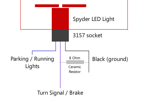

These bulbs are standard 12 volt and have the same base as a standard 3157, but you will see a much faster blink when you put them in. You have to put a bigger load on the brake light wires for them to blink at the normal rate, but it's super easy to do.
Get a pair of 8 Ohm ceramic resistors (the white block style) from Radio shack and wire them across the turn signal +12v and ground on each side. I forgot to mention this because I had put them in for the forst set of LED bulbs I ordered.
I'll post a pic of the correct ones tomorrow and make a quick diagram of how to wire them in.

Ever got around to getting that pic done up? Would be helpful to us who are gonna go do the same thing :D

The blink rate is closer to 3X witout the resistors. Here is a quick diagram, I told you there is nothing to it, just tape up all the exposed wire from the resistors, or you can use heat shrink on them and leave about a half inch of the wore esposed in either end before you solder them on.
I do recommend solder as opposed to twist and tape.
I have to double check the wire colors, I remember purple being the turn signal wire color, if I'm wrong, I'll change the diagram.
Awesome thanks!
