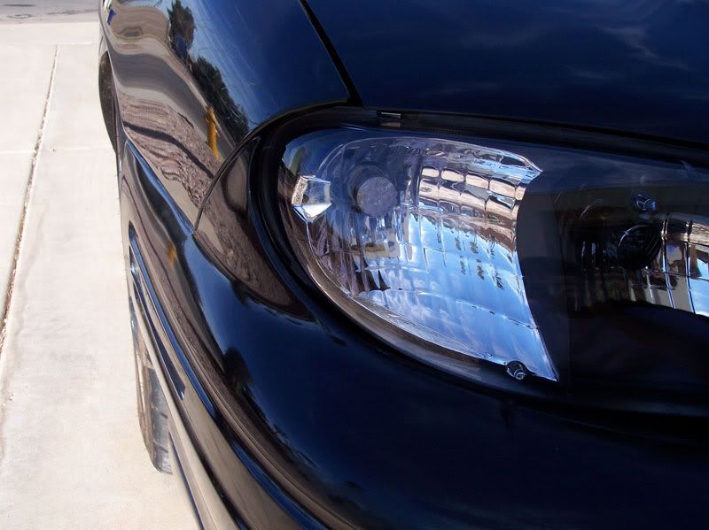

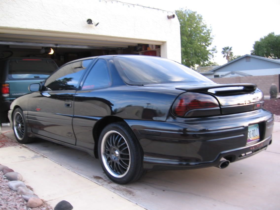

and rrasch, I used VHT Niteshades, you can get it from Summitt Racing or other online places. I used like 5 coats of VHT on the turn signals then about 3 on the brake light area, and then topped that off with 4 even coats of duplicolor clearcoat, lightly wetsanding with 2000 grit between each coat to ensure a perfect mirror finish like it was from the factory :D
