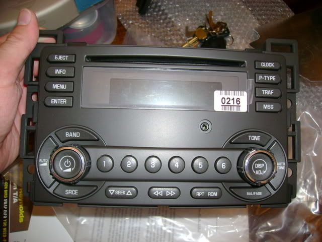

Here is mine (no graphic symbols)
and here is one with graphic symbols:
what is the funtion sybol graphic switch iam reading on gm parts direct
and maykevin is saying his 6 disk gtp stereo does play mp3 cds anyone else have the same?
Kevin is wrong.....sorry Kevin. Unless he has a 2009.5 with the black tie..?
Our radios will not play MP3. The 08+ Aux gets you by that though. :cool:
That radio in the picture was ordered and costs me ~$256.
here it is 1yr+ later and they can be found for cheaper.....but you must LOOK! :eek:
