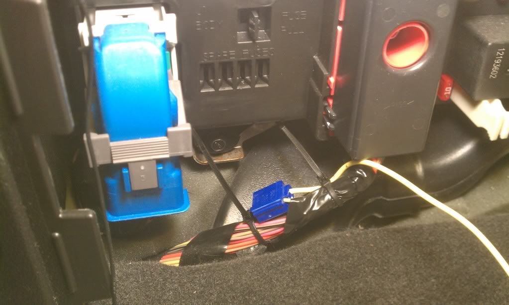

bluetooth power....
@torridpsu
Found a wire that is powered the same as the radio and did a vampire tap.
Ran that to my hacked converter and it works great.
No problems with multiple phones using the bluetooth.
As an added bonus it has spousal approval so I am good to go. :D
...tapped
...secured
-j
