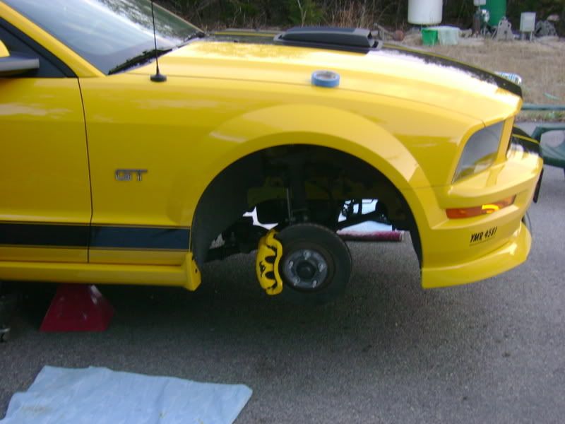

I have a few good shot of when I did my wife's Mustang if you wanna see it...principal is the same.
here is the G6:
back:
The Mustang:
After it was dried I painted the pony on....
Anyway it takes a bit of time but its easy cheesy. Just take your time in prep (tape) and make sure its cleaned good and it will come out looking great.
