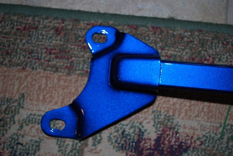

Oh yeah, pics! My biggest issue was the nut on the driver's side didn't line up with the hole (behave), so I had to drill out the hole a bit:
