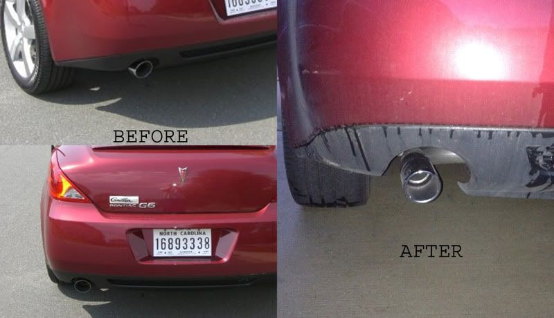

Hello everybody. I have had the same issue with my '09 G6 Convertible. They stated that there was a problem with the exhaust system (CAUSE: 9090 according to the Invoice), and they stated the following service and replaced the following parts:
L2584 Muffler Single Replace
19257426 Muffler
22734961 Gasket
CC: 0323
FC: 6063
After they replaced it the noise has gone away, but the exhaust tip is a smaller, to me it looks very strange being so much smaller than the original. Has this happened to anyone else? Is this normal? Here are some pictures:
