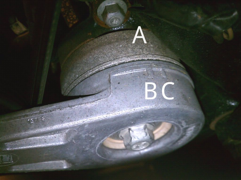

@ tensioner question
@slls
Forgot to answer this, tensioner on the 3.5 has marks as do most others, indicating the stretch or wear limit on the serp belt. Kind of a moot point though as most belts have so much kevlar etc that they just fracture and break before they stretch any real amount.
Hard to see in the pic below but on the tensioner arm there are reference marks, B & C, that are the wear limit against the mark @ A.
This pic is after I installed a new belt trying to kill the squeal.
:beer:
-jon
@slls
:beer:
-jon
Thanks, learn something new. My experience is the belt stretches so much they squeal.
