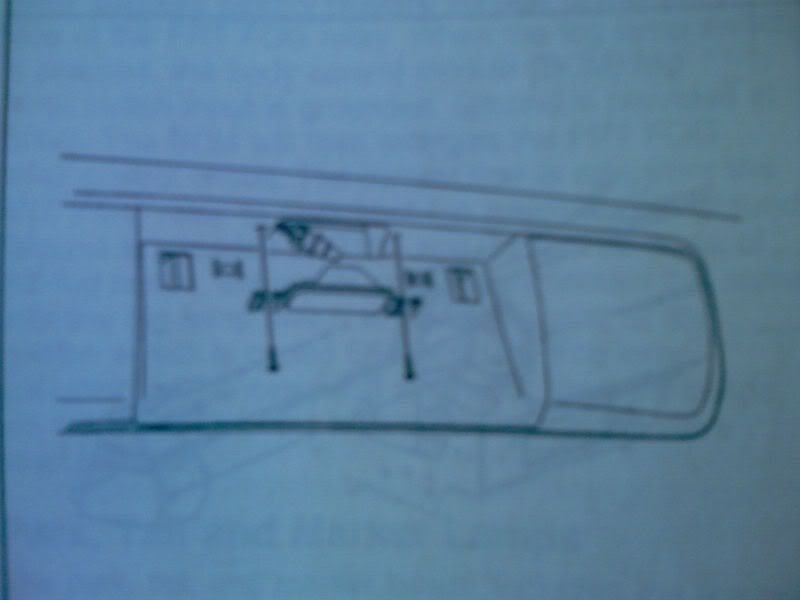

Do I have to take off the whole fender or what?
Page 8-499 from Volumn 2 of the G6 service manual says:
1. Remove the license plate lamp screws.
2. Reach into the opening in the rear bumper fascia.
Rotate the license lamp forward and downward.
3. Pull lamp through the opening.
4. Turn the license lamp socket counterclockwise to release the socket from the lamp housing.
5. Remove the bulb, if required.

Thanks for the help bro. I did try that, but I think one of the screws is stripped. good to know. thanks
