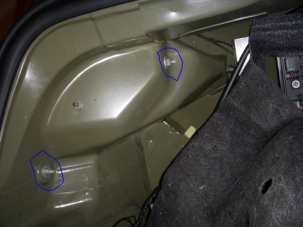

Star by removing the cargo net. Then remove Two plastic clips that are circled in Blue.(they unscrew)
Pull back the carpet/Liner. Remove two bolts Circled in blue. (IL add the size shortly)

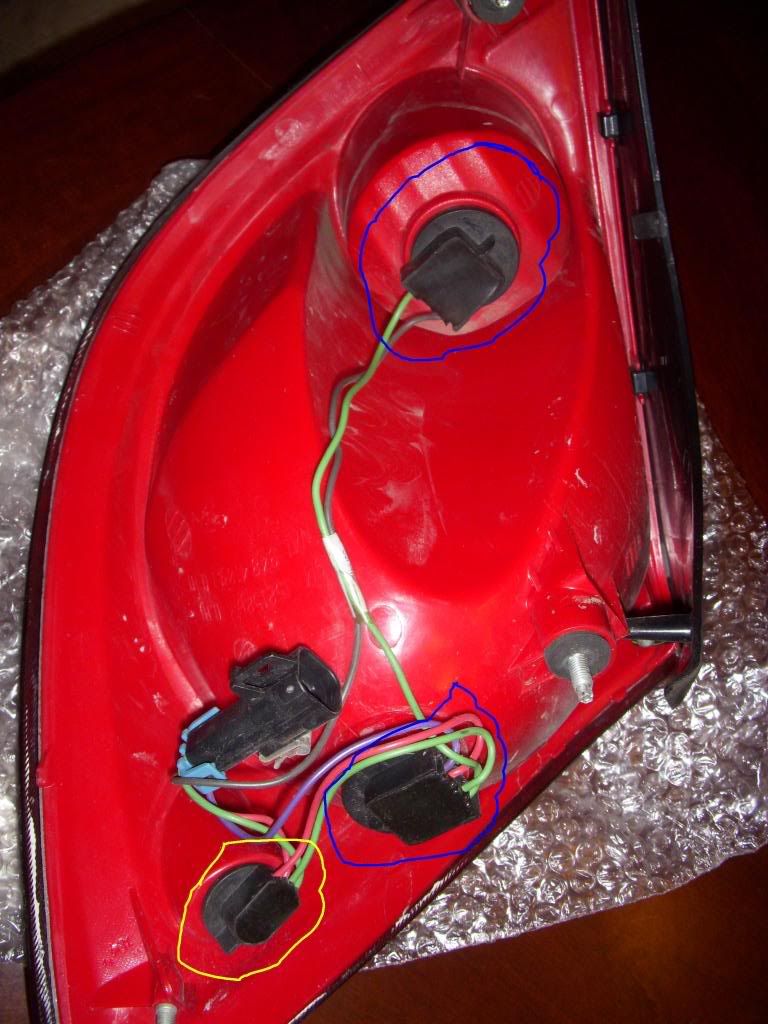

Pull light straight out and disconnect wire harness Circled.
No tools needed
Bulb replacement - To remove bulb holder twist.
Bulb Circled in BLUE are 3057*REVERSE*STOP/TURN
Bulb Circled in YELLOW 194 *REAR SIDE MARKER

Thank you
Thank you for the pictures. The other night I was completely in my trunk swearing because I could get the black clip (way in the back) to come off. Thats because I didn't need to take it off.
With your pictures it took me just a few minutes!
