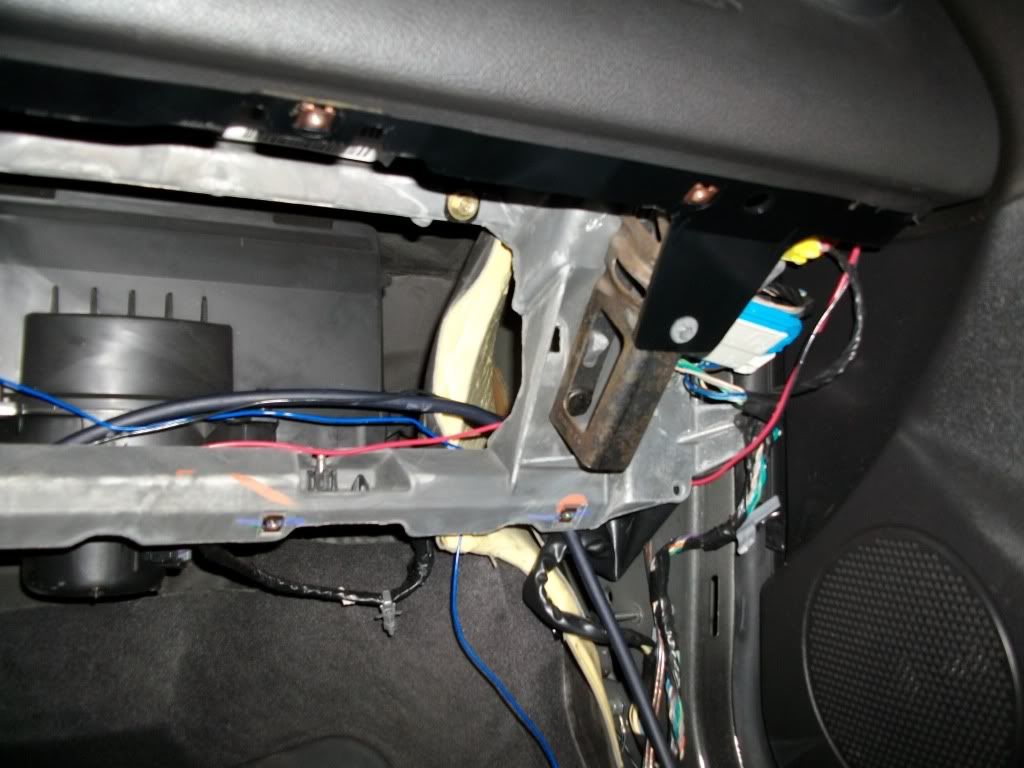

Take out the kick panels under the driver and passenger, radio shroud, that should give u enough room to wire everything its pretty easy. I actually have alot of stuff taken out of my car right now and could snap some pics. i rewired all my lites yesterday and wired up my lcds to switches. but i hurt my neck LOL real bad and am sitting in bed.

Picture of passenger with panels removed The kick panel, and the glove box.
Just take out all the screws take your time and youll see all of them the kick panel has a couple pressure clips.
Driver side take out kick panel then under the steering wheel thing not sure what its called:D
The vents come out by turning to the left or right then pull towards you.once it wont go any more forward. look inside with a flash light and there are 3 tabs bull those tabs up with a screw driver and it will slide out :beer:
My camera ran out a battery LOL so i couldnt take more pictures once those pieces are taken out. Driver and passenger side you can then remove the radio shroud so easy just pull it out towards you only has pressure clips the vents come out with it. i believe all of the screws are 7mm socket
