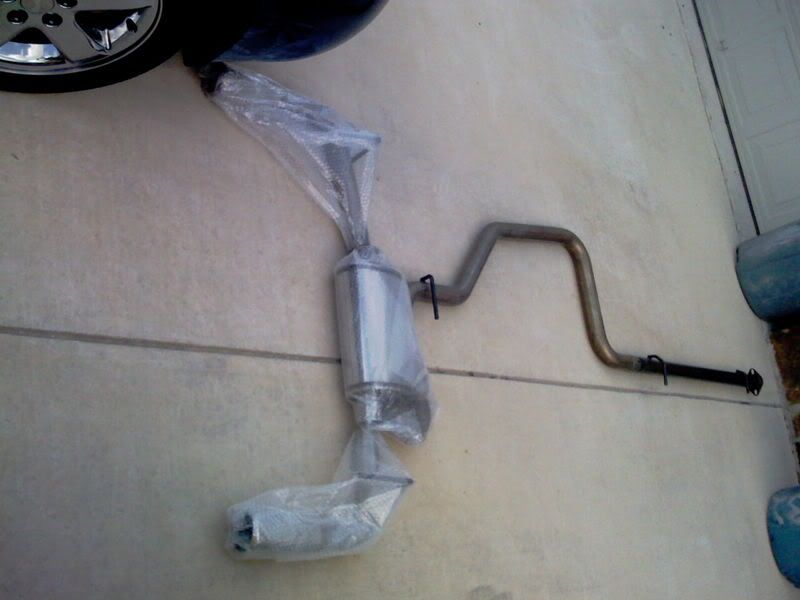

Exhaust? Im on my third exhaust. Stock...didnt like it. I wanted dual outs.
I dropped a flow through magnaflow where the resonator was and a single in dual out 2.5 maganflow in back. I wasnt happy. the 6" flow through was too big and use to hit on parking lot bumps etc. The pipes wernt mandrel bent and the guy who welded it up did a piss poor job. Ended up buying an exhaust made for the car. I am very happy with it now. The one I bought (GT-R) has a tuned muffler. He opens it up and ajusts the baffel for the best possible flow to sound ratio. Its very high quality and mandrel bent w/polished metal. Anyway....I am now happy with it. 4" tips round mine off.
I wish there was someone like me to give me advice early on....I would have saved allot of money. I thought doing it myself would save me money but it didnt.

I bolted it on myself....It installs just north of your respnator or
South of the flexpipe.
That straightpipe takes the place of your resonator only. See the two hangers on that straightpipe?
Those are what normally hangs the resonator- so you have an idea of where it ends under your car.
The internal Magnaflow baffels are tuned to the car. Sounds great.
Here are a few snaps I took a few weeks before install. Keep in mind this was before I cleaned it (I bought it used).
