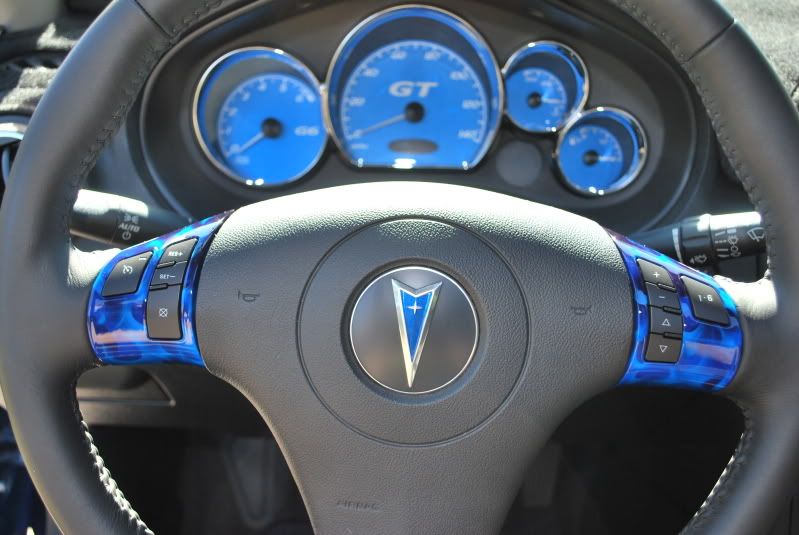

I dont really want to turn my progression thread into a How to...but dont pry on your
control housings. They dont just pop off. Look at posts #20 & #62 in this thread and you will see how they are connected. They are bolted on and the bolts are under the bag.
Your airbag has two hooks on it. The small side holes allow you to access the moveable rod which can be pushed aside to allow you to unhook it.
You can see the vertical rods in the pix below. Its been a few years but put a good sized nail in there till you feel the rod. get under it and then push toward the dash which will rock the end of the nail toward you, lifting it to allow the hook to slide free.
The hard part is then not letting it reseat itself while you do the other side....which requires constant pressure (pulling it toward you).
Also clicky here for additional help.
Also once the bag is off its just one bolt to remove the wheel. Of course you will need to disconnect the controls/bag before pulling the wheel.
Again...insert common disclaimer here---Im not responsible for your injuries, death, acne, badluck or whatever should you choose to do this.

Just dont mess with the clockspring under the wheel. There are two prongs on it that guide it via the wheel. Dont mess with it!! If you unspring the clock then your only option at that point is a new one via GM's oober pricey parts counter.
Good luck! I cant tell you enough what an awesome appearance mod it is. Well worth your time.
BUT- for those that dont know....you dont need to take your wheel off to access or mod the controls. The only reason to remove the wheel is if you want to put a different wheel on there.
All the rest can be done by merely unhooking the bag....and you dont even have to disconnect the bag! get a towel and lay it on your column and just flip the bag up and face down on the top of your column while you work on the controls. Then just flip & snap it back and your done.
I would verify all works prior to snapping the bag back in......but thats only cause it takes a bit of time to get that bag unhooked from the wheel.
