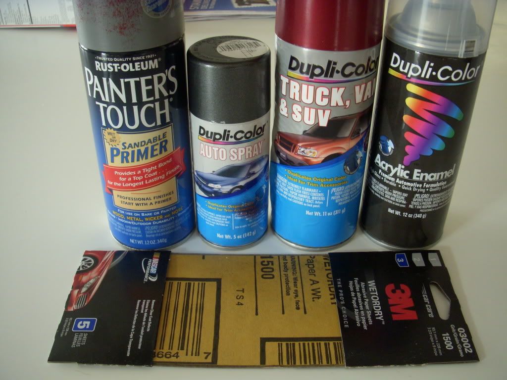

So here is the stuff i used to paint pretty cheap at Meijer Probabbly walmart has it all to.
